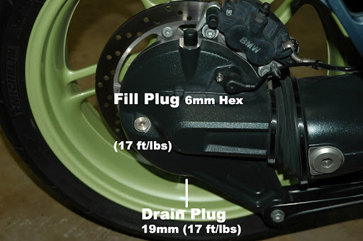

Now onto the Final Drive. This one is even easier than the transmission, since it can be filled straight from the gear oil bottle. However, there isn't much room for a drain pan underneath, so I had to improvise.
I cut up an old windshield wiper fluid bottle, and used the bottom as a catch can. This fit perfectly and kept the oil away from the wheel.
This bike had Amsoil 75w90 oil put in at the 6k mile service, so I knew it was pretty fresh. I'm not a big Amsoil fan, however.
Everything there looked fine. I took my handy dandy Stremlight Strion (it's an HID flashlight) and looked inside the FD housing, and everything looked OK as far as I could see.
The magnetic drain plug had grey goo over it, but no shavings. I used some brake cleaner and cleaned them up.
For refilling, you need to accurately measure and look to make sure the fluid comes to the bottom of the fill plug threads. I read 250ml, so I filled up the empty Mobil1 gear oil bottle to 250ml and filled the FD.
However, I looked with my flashlight and this was still below the fill plug threads. I added another 50ml and then it was perfect.
