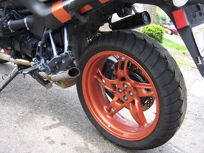

This tip cost me $8 at Strauss Discount Auto (formerly R+S Strauss).
Don't let that shiny chrome fool you though. It will look like Stranglove's tip in short order. But for $8, you can toss it and get a new one. Just keep an eye on those screws, one of them failed after 2 years.
