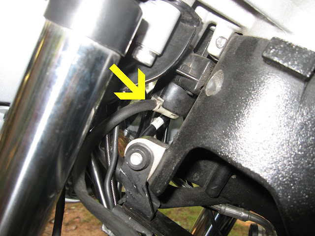

OK... so I am pretty sure I finally figured out which wire on my front-end is causing the bike to completely lose power when the handlebars are turned to the right. After several lapses of logic and pure wild goose chases, I think it is the wire that attaches to the center of the... oh, hell... see the picture below...
https://lh5.googleusercontent.com/-DWe- ... G_1389.JPG
https://lh3.googleusercontent.com/-42Rp ... G_1392.JPG
I am assuming it is directly linked to the key mechanism, since when I bend/straighten it in just the right way I can get the power to go completely off - just like turning off the key.

Got it. After a bunch of Internet searching, I discovered the set-screw under the red loc-tite. Loosened it and the ignition/light switch came right out. But like a dumba$$, I just had to take it apart. Didn't realize there were a bunch of springs and loose parts in there.
No idea how to put it back together, but it's a bit of a moot point, since I think the wiring problem is right at or inside the switch assembly. Looks like $103.68 + tax will get me a new one. :-/
Re: Wiring assistance needed...
No way to repair same. Buy a replacement from your stealership.
It is a very common problem with the oilheads. Either the zip-ties at the front or the connectors of the key switch ...

Seems like us old guys could take a lesson you. I would have done just as you have except I would have destroyed something in the process. I take it that the break is in the group of wires as they enter the switch?

LOL! Oh, I'm not absolutely positive i didn't mess something else up in the process! ha ha. Before I found the article about the set-screw, I was all ready to try to pry the damned thing out with a screwdriver. Luckily, I had at least a little sense and said to myself, "Why don't I stop until I really know the right way to do this..." Of course, in the end, I wound up having to replace the part, anyway. Oh well...
The bigger issue I still don't have a good answer for is how to remove and replace individual wires in a wire harness. I'd like to do that so that I can put a solid wrap around each bundle without doing the spiral tape wrap thing, or having to cut and re-splice all the wires after getting the covering over them.
