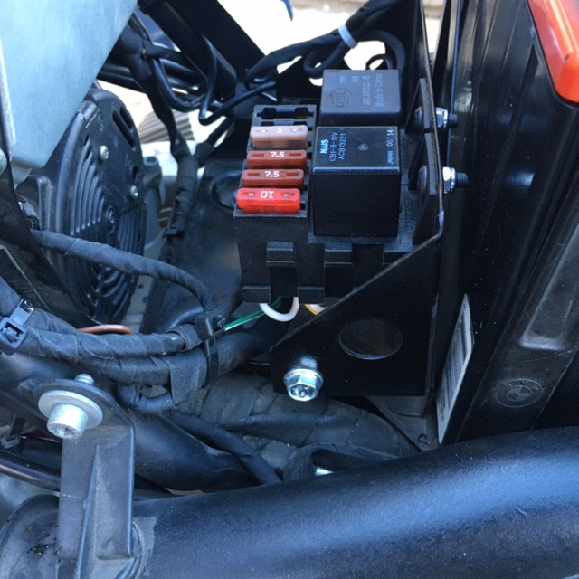

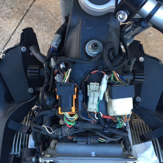

Post by Mrclubike »
riceburner wrote: Thu Oct 29, 2020 4:59 am I'm also considering stripping the auxiliary wiring harnesses from the bike and re-fitting it all 'properly', with an auxiliary fuse box and correctly wired in relays feeds etc. This would definitely require some serious garage time. The main reason for that is that I'd like to provide my partner with a feed for a heated garment. She loves riding the bike, but doesn't feel that she'd enjoy it in the colder weather. The bike already has a KEIS circuit fitted (with the 4-setting controller), and so would need a 2nd circuit fitting. I don't want to overload the current wiring which is why I want to redo the whole lot. This is something that may or may not get done!
If you dont have ABS
One place to consider putting the extra relays and fuses for an AUX circuit is right behind the Alternator in place of the ABS module
The advantage is it is right next to a good B+ source on the back of the alt
And a lot of signal sources to drive the relays are right above
Big problem of course is the tank has to be removed to access it :-k

Yup, that's where the relays for the 2 auxiliary circuits currently fitted live.
Which fuse box is that?
