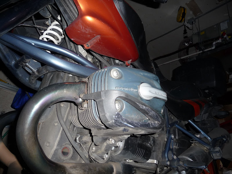

They're sturdier than I thought, and $70 each for replacement. This was the result of a 30 mph slide. A little bit of the valve cover was scratched up, but that big paint bubble was already there, so I wasn't bothered much by it.
Here's a closeup, zoom in when you get there

I've seen an R1100S with those BMW plastic covers be knocked off and the bike went "over-top" and the guards didn't stop the magnesium cover being holed.
I have a pair of Stanton guards that provide full coverage. (no longer available, but Steptoe on UKGSer makes a similar piece of kit now)
They're ally so not too heavy, and they work, repeatedly.
