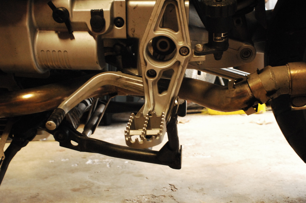

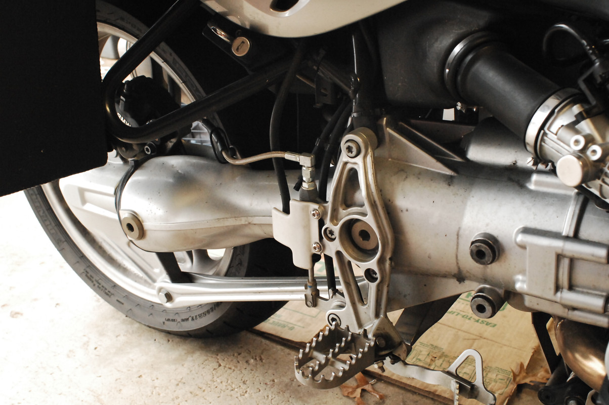

Here is a picture of my GS peg mounts on my 04 R
I got them off of eBay and they come with the MC
The brake line come from the local hot rod shop here in St Louis
I would think the OEM GS hose would have work just fine but i wanted to get it going ASAP
I also think the Roadster MC could also be used if you could rig up the brake line with a 90 deg fitting at the MC
The pegs are from a 07 GSA they were free but I had to modify them to make fit and I could not make the springs work

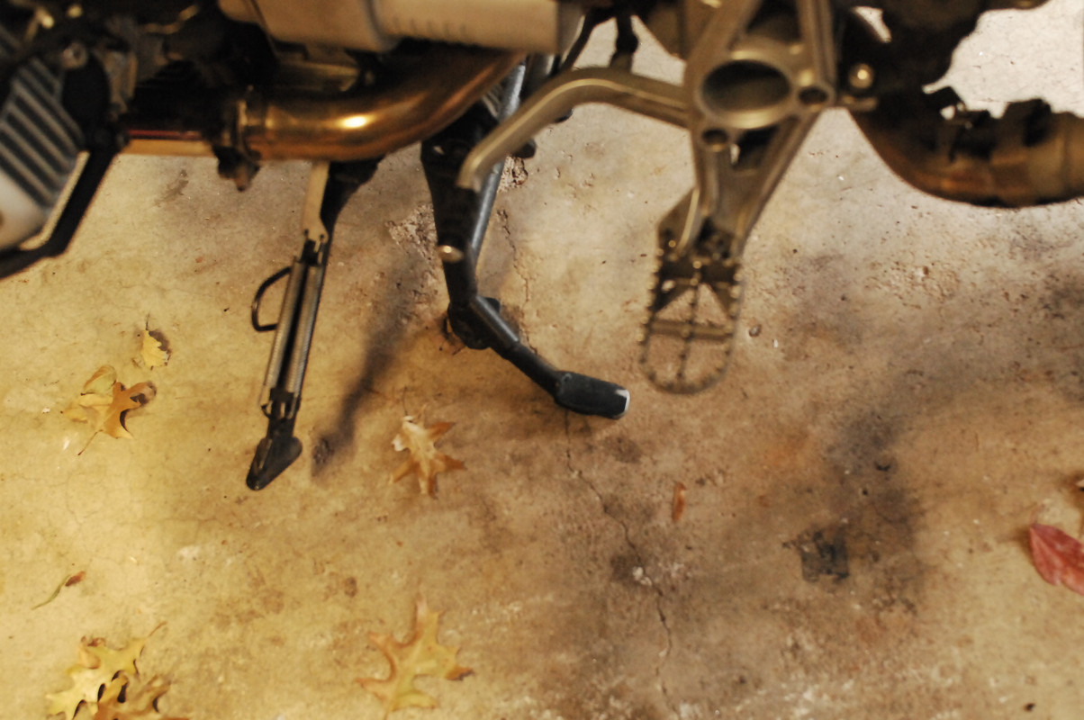

Here are pictures of the center stand after it was cut and modified to clear the GS pegs

Be careful. We already drag the stock pegs and yours are looking really low now.

swamper wrote:Be careful. We already drag the stock pegs and yours are looking really low now.
Yes I was concerned about that
They Guy that rides with me most of the time has been watching me in the twisties and he hasn't noticed me getting to close.
I do ride fairly conservative and it hasn't been a issue yet
Any way I have a lot more clearance than the Harley's we see . :shock:
I only ride solo so maybe that helps to
