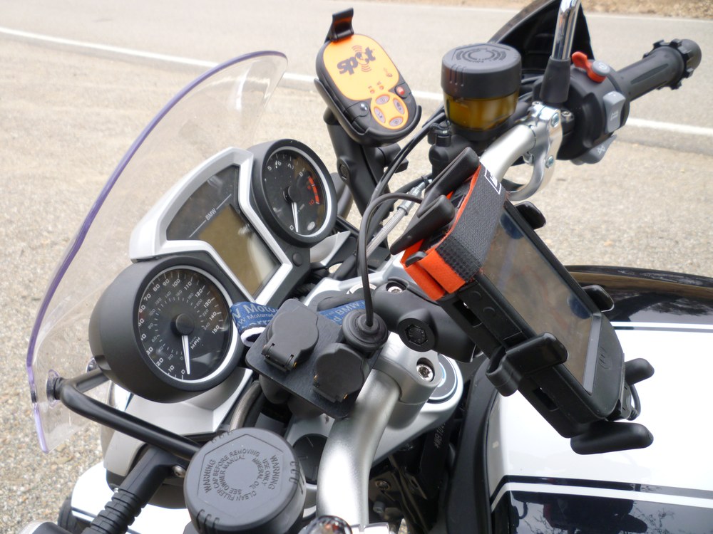

I use an iPhone/Navigon rig, but the mounting could work with any GPS.
I replaced the front left clamp with an SW-Motech RAM ball (had to find a longer bolt, I think I ended up using something from a Touratech kit for the GS bikes. I also used a plate with two Powerlets. I use a shorty RAM arm to position it - I like it a bit higher so I can glance at it easily.
I think the Touratech mount is pretty cool as well. If I were to switch to a separate GPS, I would consider that one with their locking mount.
