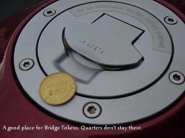

Don't
know how to store this stuff?
Try this! Here is another
cute storage trick with coins. - Cyclerob

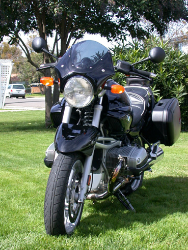

These
are pictures of Dave's (#2) bike with the new Givi screen attached: pic1,
pic2, pic3.
See down below for another image.

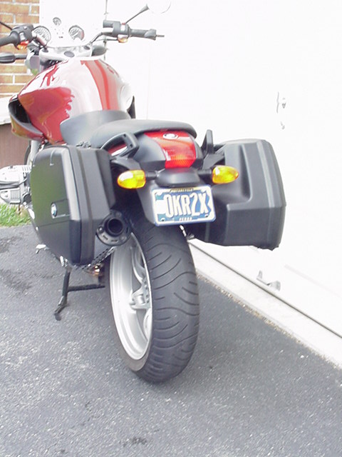

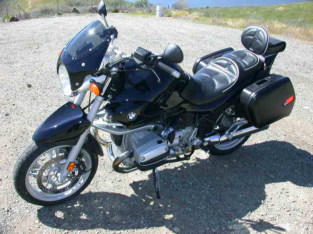

"Here's
an image I took of my bike on the way back from Corbin today. The image
shows what a Givi A750 looks like with the windshield cut down,
a Corbin seat, a removable Corbin backrest, lowered muffler
w. "Wudo" parts, and the bags with some City lids
on them." -Patrick W.

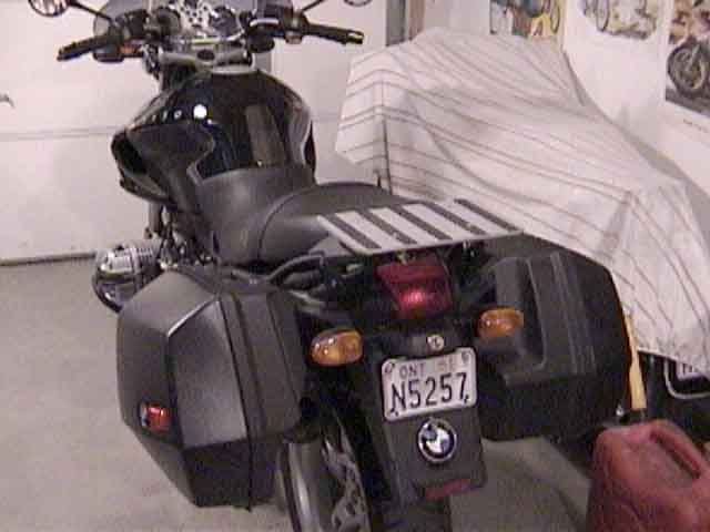

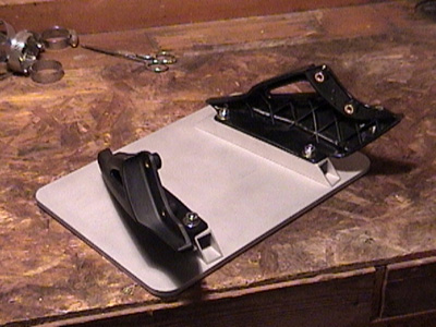

Dave
writes: "Attached are pictures of the luggage rack I made for
my 1150R, specifically for carrying my Eclipse tail bag. That setup is only
on the bike for trips. The rack is made of a sheet of 3/16" T6061 (hard)
aluminum sheet on two 3/4" thin wall aluminum tube spacers to attach
to the BMW brackets. I put strips of stair tread traction tape from the
hardware store on top to keep stuff from sliding around, with countersunk
stainless screws to hold it together. It looks just like a Krauser rack
I had on a bike in the early 80's.
For fabricating this type of item I would recommend the following machinery
as a starting point: Bandsaw with metal cutting blade for all the cutting
chores. (Found mine at a yard sale for $20!) A bench mounted belt / disc
sander combo is fabulous for finishing the cut edges perfectly straight
and smooth, and radiusing corners. Beats the living heck out of using a
file, and they are reasonably priced. I also have a sandblasting cabinet
(home made for about $30) for applying the final glass beaded finish. Stuff
comes out with a factory smooth satin sheen. The only expensive part is
a compressor with enough capacity to feed the sandblaster, but it has a
lot of other uses as well."
Rack-Bottom,
rack-rear |

think. They sell it for 179 guilders (approx. 70 dollars). I threw their brackets
away, drilled four extra holes and then it fitted nicely between the turn lights
as you can see on the attached pictures. It is also quite effective.

Greg M. writes: "It's
hard for me to really know what the pros and cons of this seat are as I bought
the bike used (six weeks old) and the previous owner put it on. So, I've never
ridden a stock seat. This seat was custom made at the Corbin factory. It uses
the original base pan. The owner said they wanted to keep his bike for a week
and prototype it for the future release of an R1150R seat but he declined as he
rode it daily. He only had the front seat made as he would never be carrying passengers
so, the back seat is stock. I wish he had as I do and the hardware would be there
for a backrest which my wife would really love! All I can say is, I find it incredibly
comfortable! I can't benchmark it with the stock all I can say is I feel moulded
to the bike, this puppy was made for me. Oh, tech heads might want to know I'm
5'9, 170lbs(fluctuates ;^) 32 inside leg, (can put feet flat at lowest point,
pads of feet at normal seating position, 34" waist, shaved head and a wee
goatie thingy. I've just joined the ranks after being an airhead for a while '86
R80. I loved that bike, but this ones feels like an airplane. If any one has any
questions, feel free and drive carefully out there..."

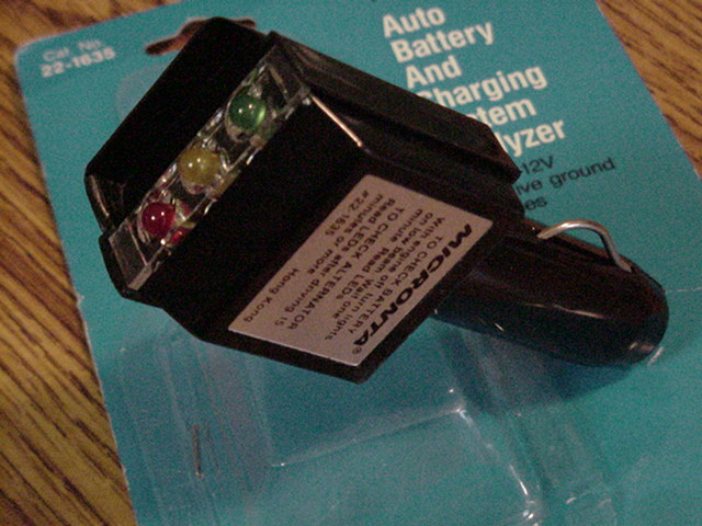

Cyclerob:
"I installed this on my VX800 then moved to my R1150R. It is a digital
LED voltmeter from Radio Shack purchased 3-27-94. It's $7.35, very accurate,
small & self powered. It was meant as a 12V Lighter plug in to test
the battery & charge System. I cut off the plug part and wired it to
an ignition-on hot wire. The catolog number is 22-1635. It may still be
available in a dusty corner of an obscure Radio Shack somewhere. I checked,
radioshack.com ,there isn't an exact present day equivalent. |
The
red/yellow/green
LED's indicated voltage
in an ingenious way:
| Color |
VDC |
| Red |
2.1--11.0 |
| Red&Yell |
11.1--11.3 |
| Yell |
11.3--13.1 |
| Yell&Green
13.1--14 |
| Green
14.1--15.9 |
| Red&Green |
15.9+ |
Starting
your bike it would show bright Yellow with key on. Cranking on starter you'd see
Red or Red&Yellow. When motor started, Red fades out, Yellow gets bright,
Green appears, Green gets bright, Yellow fades out. Looking at chart above, you'd
know your battery & charge system were working AOK. It is so small, you could
drill 3 LED holes in any hidden/visible panel & hot glue it in place behind
it. Over the years cruising the 'Shack', I've seen variations of this type "12V
test equipment" come & go. On my Beemer it's very boring cause the charge
system is so stable/powerful normal ALL THE TIME [2 widder vests + HotGrips].
Good luck in your search for Cat# 22-1635."

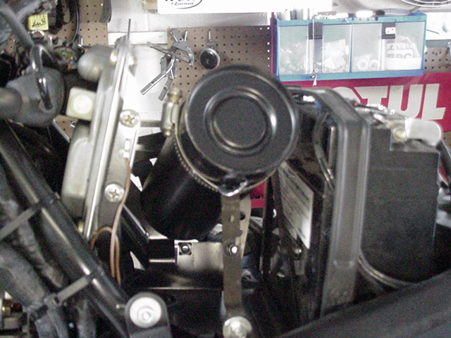

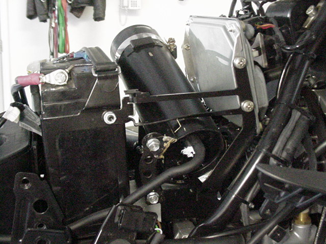

Cyclerob
also Relocated the charcoal canister to the Non-ABS space under the
fueltank! It fits there in the exact same position & orientation as
on the tail section to not alter any functions. He then bought the BMW system
city cases & they have a bulging relief into the bag volume just for
that cannister that's not there anymore. C'est la vie.
Here are some of his other cannister re-location pics:
One, Two,
Three |

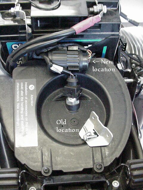

Cyclerob
writes: "I've always thought that diagnostic plug was a tacked-on
afterthought of an eyesore so I just put it where it belongs & eliminated
3 parts. The picture shows the diagnostic plug's bracket removed and the plastic
holder re-located to the upper portion of the airfilter lid for more useful storage
space & a neater integrated appearance.
First, remove the plug from it's plastic holder. Unscrew the aluminum bracket
from the lid. The plastic holder can be removed from the aluminum bracket by firmly
pushing the straight center pin out (either way). Then drill a 9/32 hole in the
upper middle of the airbox lid, on the "dirty" side of the air filter,
missing the internal web, and install the plug holder into it. Lock it in place
on the lid with the center pin & re-install the diagnostic plug so it's wires
are neatly out of the way. The BMW mechanics can still easily access the plug

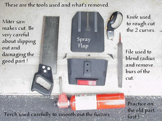

Cyclerob
chopped his rear fender. (He is the master manipulator!!!!)
Here
are some tips:
"Before cutting, remove the torx center screw and slide out the spray
flap. Be VERY careful about slipping out of the cut groove when sawing.
I was, it didn't. I sawed it off with the license plate on, as a guide
- - be sure your plate is on straight first. For the radii you can take
careful chomps with a pair of dykes (wire cutters) then blend it in with
the razor knife. I just eyeballed it & cut, but you can get anal &
make a template for the radii & flip it for the other side. If unsure
of your skills, try practicing the whole cutting/trimming/blending/heating
operation 4 inches lower on the fender to see how you do. The second time
is easier and you'll do a better job." -Cyclerob

Tom
added a set of Hyper-Lites, the brake-light flashers (www.hyperlites.com).
He writes: "These should get me noticed more when stopping, particularly
at night. I bought the set from Adventure BMW and it was a bit cheaper than
ordering directly from Hyper-Lites. The folks at Hyper recommended the set
for the BMW GS. However, the guys at the shop suggested the R1200C set,
since it uses spade connectors. [I have these as well, and
used a set from my old F650gs -Doug]
The install
was pretty easy, about a 1/2 hour all together. I used a mounting bracket
that sits behind the license plate and ran the wires up under the brake
light. I did have to modify the connectors a little, as the male and female
pieces both had protective sleeves. I cut the sleeves off of the Hyper-lites
portion, since those were a bit less expensive :-). I also had to expand
the female connector for the 12v line so it would fit over the spade on
the light assembly. I covered all the connections with electrical tape
and gathered the wires behind the brake light cover. It took a little
creative maneuvering since I have the tail rack on the bike, but I got
them all under there. So far I'm very impressed.
"Here
is a recent picture showing the back of my bike which has been modified
2 ways.
1. Hyper lites installed (ABS version bike)
2. Rear fender hacked off" - Brad E.
